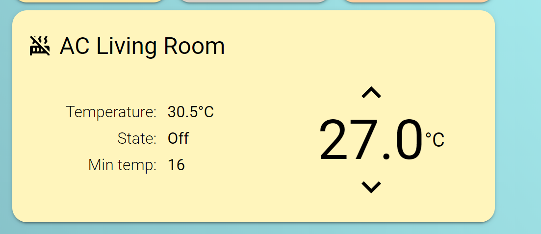

hi, need some help with the config…
i’m trying to achieve the following from the example above, i tried a few options without success, back to the original code below :
          - type: horizontal-stack
            cards:
              - type: custom:simple-thermostat
                entity: climate.mzgn_slvn
                style: |
                  ha-card {
                    background: #fff5bc;
                    border-radius: 15px;
                    --primary-text-color: black;
                    --secondary-text-color: black;
                    --paper-item-icon-color: black;
                name: AC Living Room
                step_size: 1
                sensors:
                  - entity: sensor.fibaro_system_fgwpef_wall_plug_gen5_power
                  - attribute: min_temp
                hide:
                  mode: false
This is the result :
i would like to add the buttons: cold and heat as in the example below
Anyone can help with the code?
