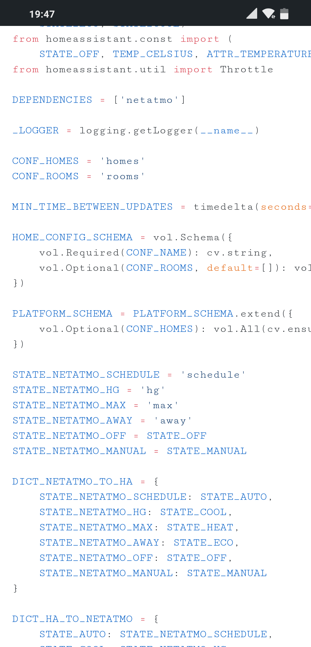

This is the netatmo.py that is used in Ha to manage the Netatmo Thermostat.
The states are the same that I used, heat and idle for sure.
I’ve tried also only those two, without quotes, with no success.

I think that most probably the Netatmo Thermostat component have just two states, idle and heat.
Some other states, like away, are not sees as state but are seen as an attribute, as in screenshot below.
