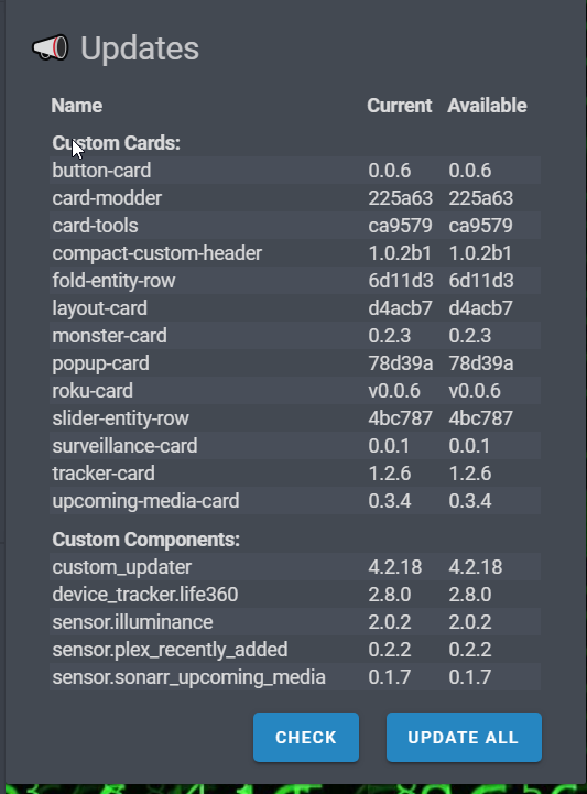

I also have never had Simple Thermostat show up in the Custom Updater Tracker Card. Tried everything you have and nothing seems to work.
Very peculiar. Have you tried installing it using recommended method for custom_updater:
resources:
  - url: /customcards/github/nervetattoo/simple-thermostat.js?track=true
    type: module
This should most definitively work and bypass any local downloading in the first place. Please try and see if that makes a difference.
Thanks that worked and it now shows in the updater. Not by restarting HA but using services: custom_updater.update_all.

in my ui-lovelace.yaml and I did as suggested above by @Trouble-51 by using the service instead of just clicking the button on the card, but as you can see below, still no love for your card in Custom Updater. :sob:
