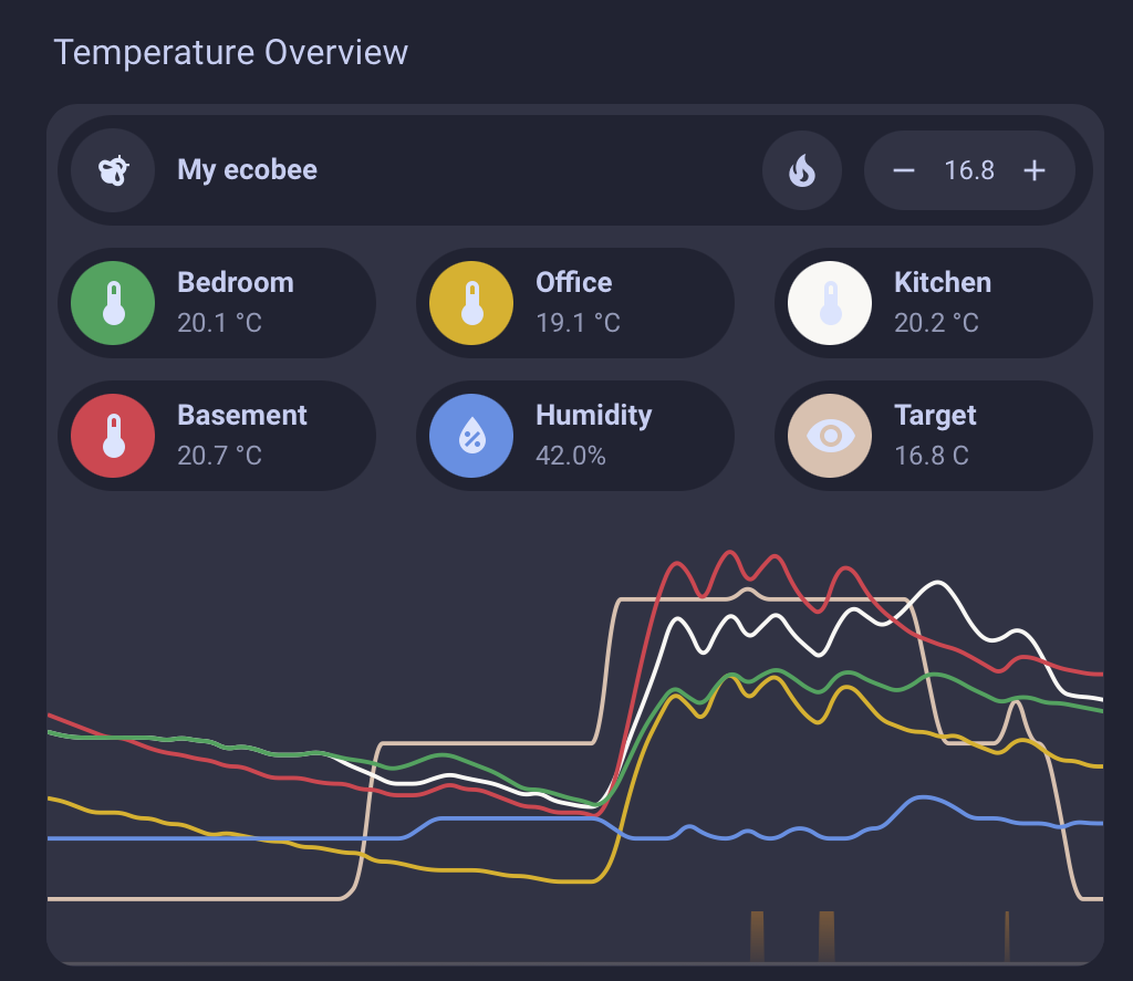

Thanks for this inspiration! I took it a few steps further and ended up with this. Kind of a mash up of your original mixed in with how Beestat displays data, or at least as close as I could get it using what is natively available in HA.
That looks super clean. Mind sharing the config? :pray:

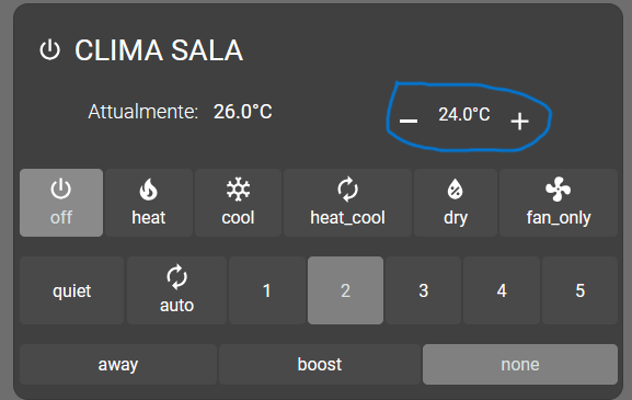

hello, i have update last version home assistant and now i see small value temperature 24°C.
Can you help my solve in my card problem ?
type: custom:simple-thermostat
entity: climate.clima_sala_room_temperature
layout:
  mode:
    headings: false
    icons: true
  step: row
header:
control:
  - hvac
  - fan
  - preset
show_header: true
hide:
  state: true
  temperature: false
style: |
  ha-card {
    --st-font-size-xl: 50px;
    --st-font-size-m: 20px;
    --st-font-size-title: 20px;
    --st-font-size-sensors: 20px;
    --st-spacing: 4px;
    --st-mode-active-background: gray;
    --st-mode-active-color: white;
