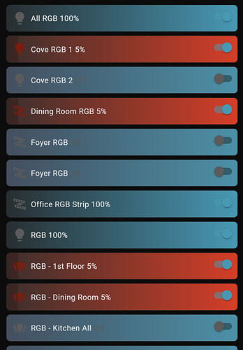

Solution: How to create Slider Button Cards inside Auto-Entities that use filters
I searched a ton but did not find anyone post use with Auto-Entities Filter cards. It was not intuitive (not much with dashboard cards is!) and Claude & ChatGPT didnt know either.
Hope this helps others (wish people would post more code and screenshots!)
If you change the columns to a different number it will change the card sizes, etc. you can also use vertical-stack or other card types in place of grid.
type: custom:auto-entities
show_empty: false
card:
  type: grid
  columns: 1
  square: false
card_param: cards
filter:
  include:
    - domain: light
      options:
        type: custom:slider-button-card
        compact: true
  exclude: []

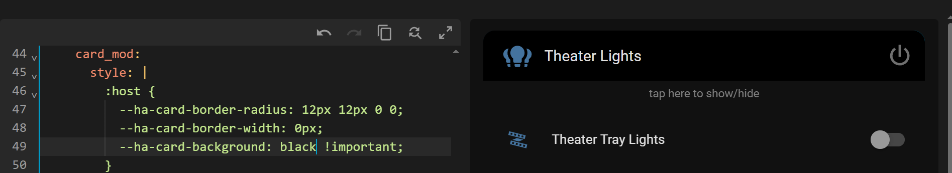

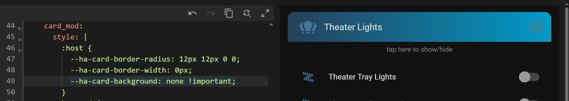

How to make the background transparent?
I have tried multiple card-mod settings and no matter what I try, it never removes the background color. Here's some screenshots showing the results trying the setting...
these do not work
--ha-card-background: none
--ha-card-background: transparent
setting a specific color works...
--ha-card-background: black
