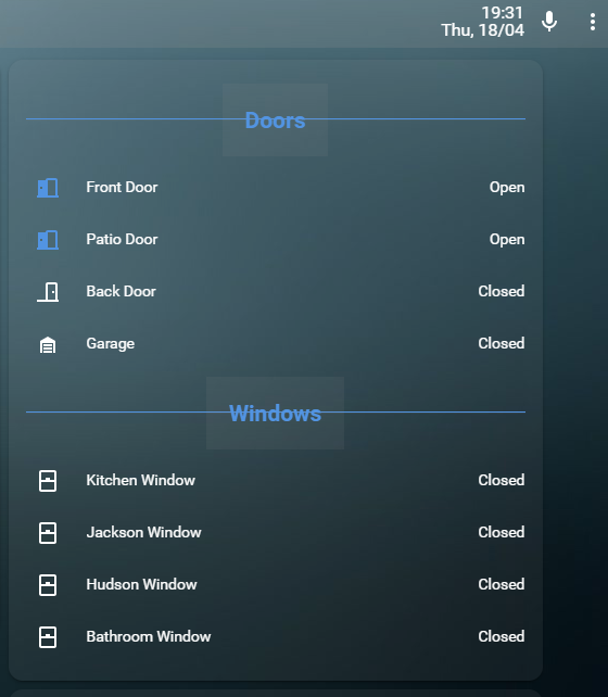

My divider is showing the line through it? Have I done something wrong?
- type: vertical-stack
- type: entities
#title: Doors
show_header_toggle: false
- type: 'custom:text-divider-row'
text: Doors
- binary_sensor.door_window_sensor_158d00022016b2
- binary_sensor.door_window_sensor_158d000225432d
- binary_sensor.door_window_sensor_158d0001e73c09
- binary_sensor.garage
text: Windows
- binary_sensor.door_window_sensor_158d0001e73af4
- binary_sensor.door_window_sensor_158d0001e73a73
- binary_sensor.door_window_sensor_158d0001e73aad
- binary_sensor.door_window_sensor_158d0001e74875
You dont have to have text right?
The background uses --paper-card-background-color from the theme. Is that set in yours?

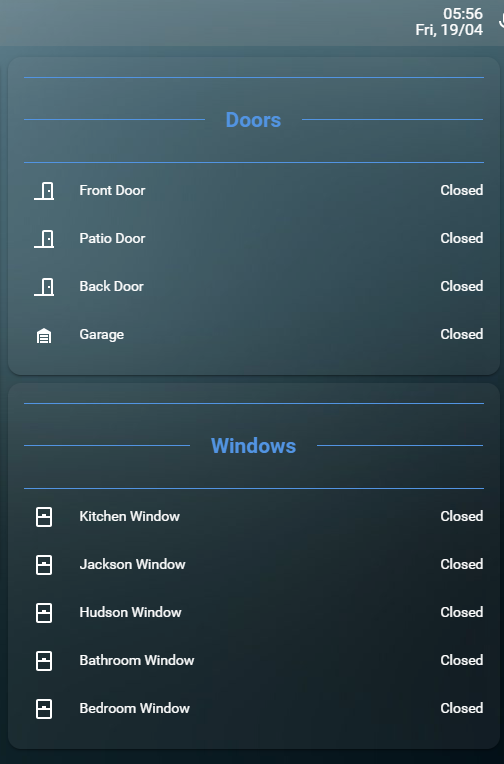

Opened a PR with a fix for the transparency issue
Awesome! Merged. Thank you.
