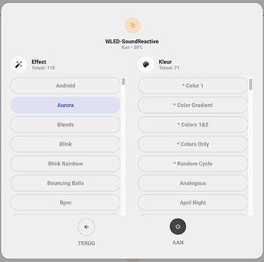

The next release will have a similar feature added to the popup cards where you can set the effect and color-palette. This also works for the mediaplayer as source selector
Some sneak-preview:
Desktop:
Mobile:
PS: If you want to have existing changes to official cards itâs best practice to copy the code over to your custom_cards directory, change the template name to something unique and use that to config your cards.

Big thanks for this. Just one question: On your screenshots, few posts before, there is also Color Palette list. I just updated minimalist ui, and I have Effects list in popup, but Color Palette is missing on my WLED instances. I can see there are popup_light_effect.yaml and popup_light_palette.yaml inside default installation directory, but Color Palette is not showing for me. Should I do something to enable it or where am I mistaking?
Just for note: I already have enabled Color Palette select entities (they were disabled in HA per default, as per documentation).
Many thanks.
The docs are now updated, how have to add the select entity into the variables part of the card.
https://ui-lovelace-minimalist.github.io/UI/usage/popups/popup_light/#card-compatibility
