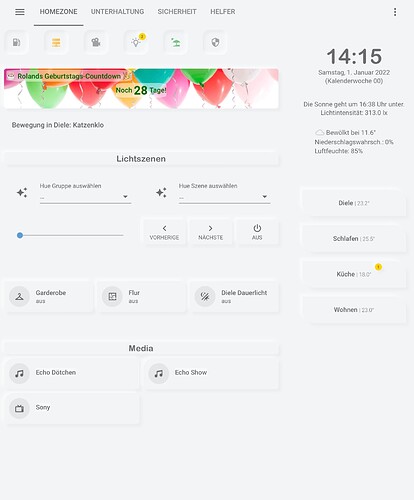

Hey @flave, I’m using the new sidebar feature:
title: Homezone
path: panel-diele
type: sidebar
#### SIDEBAR
  - !include sidebar.yaml
It is not ideal, but ok for my needs.
sidebar.yaml:
#### SIDEBAR
type: grid
columns: 1
square: false
  - !include uhr_sidebar.yaml
  - !include wetter_sidebar.yaml
#### SIDEBAR - NAVIGATION
  - type: custom:button-card
    entity: group.diele
    template: panel_navigation_sidebar
    entity: group.schlafzimmer
    entity: group.kueche
    entity: group.wohnzimmer
view_layout:               ## IMPORTANT!
  position: sidebar
#### END ####
uhr_sidebar.yaml / clock - date - sun - lux:
entity: sensor.time
triggers_update: all
show_icon: false
show_name: true
show_state: true
show_label: true
tap_action:
  action: more-info
name: "[[[ return entity.state ]]]"
state_display: |
    var tag = states['sensor.datumsanzeige'].state;     ## sensor date
    var kw = states['sensor.aktuelle_kalenderwoche'].state;     ## sensor calendar week
    return tag + '<br>(Kalenderwoche ' + kw + ')'
label: |
    var s = states['sun.sun'].state
    var auf = states['sensor.sonnenaufgang'].state;     ## sensor sunrise
    var unter = states['sensor.sonnenuntergang'].state;     ## sensor sunset
    var lux = states['sensor.lux'].state;
    if (s == 'below_horizon')
    return 'Die Sonne geht um ' + auf + ' auf.';
    return 'Die Sonne geht um ' + unter + ' unter.<br> LichtintensitÀt: ' + lux + ' lx'
styles:
  card:
    - margin-left: 40px
    - width: 25vw
    - padding: 0
    - border-radius: 0%
    - box-shadow: none
    - color: var(--primary-text-color)
    - font-size: 13px
  grid:
    - grid-template-areas: '"n" "s" "l"'
    - grid-template-columns: max-content
    - justify-content: center
  name:
    - font-family: Arial Rounded MT Bold
    - font-size: 42px
  label:
    - padding: 13px 0px
    - white-space: pre-line
#### END ####
