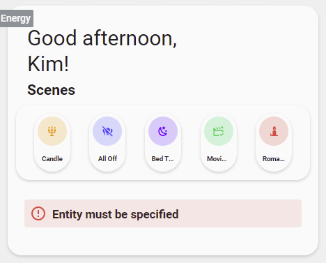

Go to your dashboard, type ā€œcā€ on your keyboard and reload the UI-minimalist-integration in this pop-up
. Than you can renew your dashboard and all changes should be applied (except from some cache errors that sometimes will happen) :wink:
In my browser I get this.
But it works on my phone.
      - type: horizontal-stack
        cards:
          - type: "custom:button-card"
            template: custom_card_welcome_scenes
            variables:

Also when I use the custom card I just get a empty page on my wifes iPhone 13 Pro Max. Any ideas?
I guess you did not specify a weather entity as the error asks for a entity in the part where the weather info should be showed.
Just add it here:
            variables:
              ulm_custom_card_paddy_welcome_time: sensor.time
              ulm_custom_card_paddy_welcome_weather_provider: weather.<Your_Provider>
Thank you for the reply, just tried it (simply changed one of the card titles) and then did what you suggested but no change still
also that reload just maps to this in the configuration menu right? i have tried that aswell with no success :frowning:
That should work the same. I don’t use the VSCode add-on but VSCode directly on my PC. There I need to make sure I have saved the changes in VSCode. Than reload the integration, either by typing c or go to the server page. Than I need also reload the dashboard with the 3-dots in the upper right corner of the dashboard.
That did the trick! What if I don’t want to show the weather?
