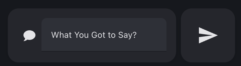

Step 3: Add the Lovelace Card
Create a card with:
  • A text input field for entering the message.
  • A “Send” button to trigger the script.
  1. Edit your Lovelace dashboard.
  2. Add a Manual Card and use the following configuration:
    type: horizontal-stack
    cards:
      - type: entities
        entities:
          - entity: input_text.message_to_bedroom
            name: What You Got to Say?
            icon: mdi:chat
      - type: custom:button-card
        icon: hass:send
        show_icon: true
        show_name: false
        styles:
          card:
            - height: 90px
            - width: 90px
        tap_action:
          action: call-service
          service: script.turn_on
          service_data:
            entity_id: script.announce_tts_message
  3. Save the card.
Step 4: Test the Setup
  1. Open your dashboard.
  2. Enter a message in the text field (e.g., “Wake Up Time!”).
  3. Press the Send button.
  4. The message should:
    • Be announced on the Google Home speaker.
    • Reset the text field to blank.
