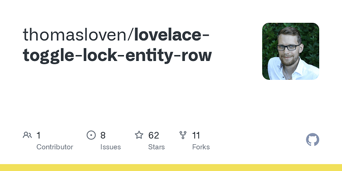

  - url: /local/toggle-lock-entity-row.js?v=1
    type: js

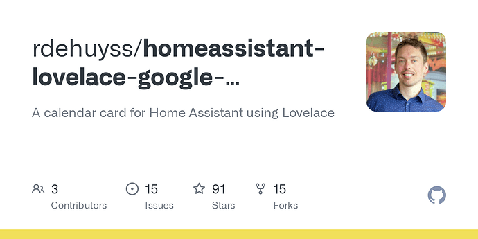

  - url: /local/custom_ui/calendar-card/calendar-card.js?v=1.0.1
    type: module
