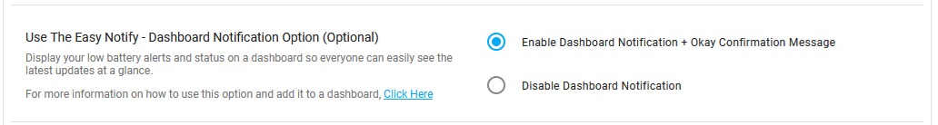

1. Enable the Easy Notify - Dashboard Notification Option

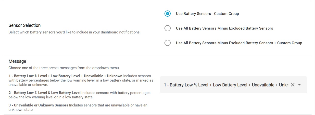

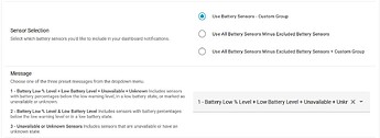

3. Sensor Selection & Message inputs.
Select the sensors and message options you would like to use.

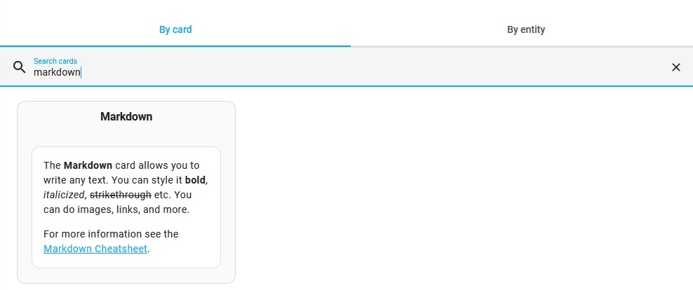

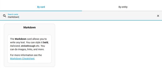

6. In your dashboard you will need to add a new card
  1. Click the pencil icon (top right) to edit your dashboard.
  2. Select + ADD CARD.
  3. Search for and select the Markdown Card.
  4. Enter in your title

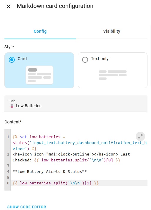

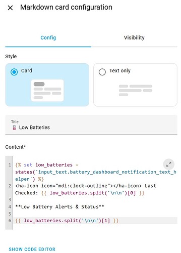

  5. In the Content field, paste the code below:
  • Replace input_text.battery_dashboard_notification_text_helper with the actual entity ID of your text helper.
  • Update Low Battery Alerts & Status to your preferred wording and language.
    {% set low_batteries = states('input_text.battery_dashboard_notification_text_helper') %}
    <ha-icon icon="mdi:clock-outline"></ha-icon> Last Checked: {{ low_batteries.split('\n\n')[0] }}
    **Low Battery Alerts & Status**
    {{ low_batteries.split('\n\n')[1] }}
    Feel free to customize the code further to match your style. :grinning:

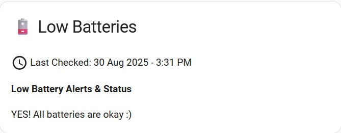

  1. Click save and run the automation.

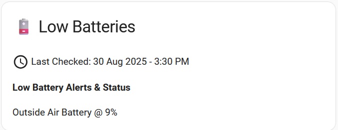

    You should now see your Low Battery Alerts displayed on the dashboard.
    It will look something like this:
Note - If there are too many batteries, some may not be displayed.
