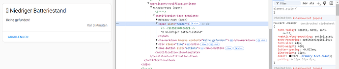

This will be a browser setting blocking the emoji being downloaded.
Blacky :smiley:

in regards of the emoticon, seems to me more its a not supported char or not correct encoding for chrome

i just checked, unicode is working, but chrome and edge as an example do not support low battery unicode.
