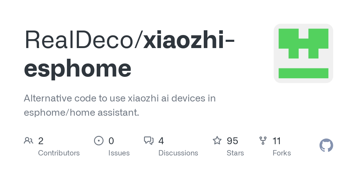

i see it’s my code in the pastezen, you could have just posted the link:
