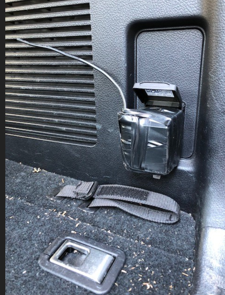

I needed a zero latency presence detection when I first installed HA couple year ago so I installed this RF transmitter in our cars. It is hooked up to the car power outlet so it transmits all the time when the car is on. When we start the car or are within 500ft on arrival, the RF receiver tells the pi and HA of our presence. It is 100% reliable and instantaneous.

@RobDYI, This looks like exactly what I need, can you tell us more? A picture or 2 would be great.

I have several USB ports in the car to plug into. Is the wire in your picture an antennae?

You are suppose to uncurl the antennae on the transmitter in the picture. I have my pi in my basement located near where all the phone wires end up. I used a unused phone wall outlet to put my receiver in. I then transmitted the power and other wires from the pi to my front 2nd floor room for the receiver. The car gate is fully open by the time I pull up to the house in a medium density suburban neighborhood. You need to put a little programming into your automations because the binary sensor will flicker at first which might cause problems.
