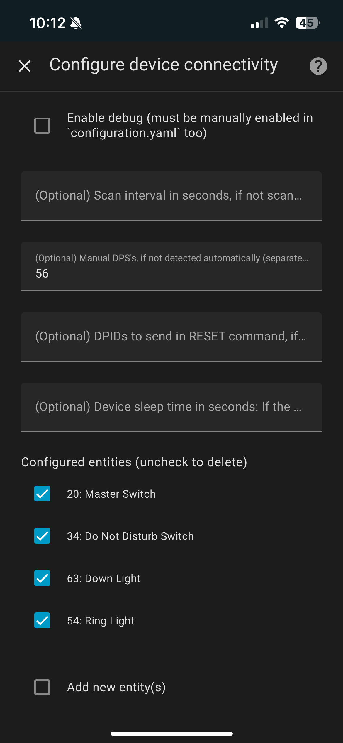

Hey. Thanks for sharing this. I’ve been spending some time setting these lights up in local tuya. When I am configuring, DP ID 56 isn’t available as an option to select so I have to pick 55. Did you do anything specific to make ID 56 available?
Use Studio Code Server and save this as
CONFIG/custom_components/localtuya/templates/Lumary_RGBAI_Config.yml
Use it when adding the lights.

Hey. Just got around to messing with these again. For the ring light, DP 56 didn’t automatically show up even when using a template. Had to manually enter DP 56 and got it working.
Then you can use the template from @theblbdan to configure.
@andreasc yes I did get them working. Let me know if you have any specific questions on setup. Happy to help.
I am still having trouble to configure this. DPI 63 and 56 doesn’t exist so I added in manual DPS field. But configure it didn’t made it work.
How did you expose the two entities with one being the ring light? I only can view do not disturb and the light it’s self as my two entities.
