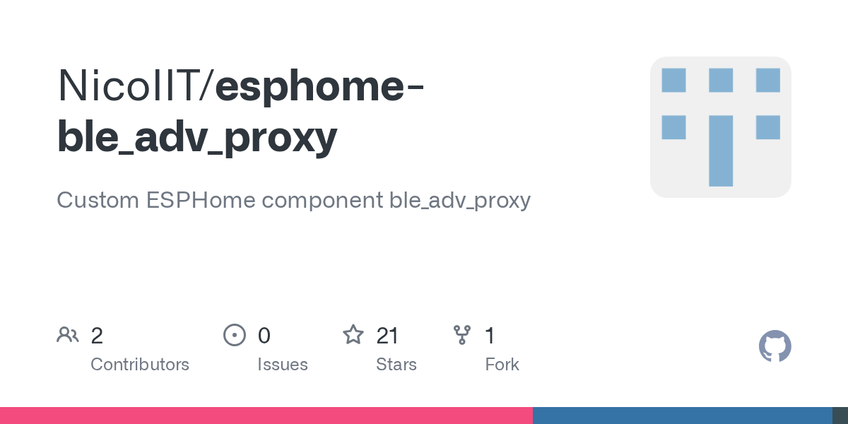

I had a working configuration. But with every ESPHome update, I was afraid it might break. Now I’ve found a better solution for me. I switched the ESP to a BLE proxy and followed the description I found:
Good Luck.
