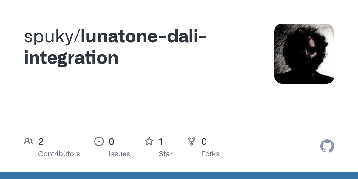

Since I needed an integration and I did not want node-red… i vibe coded one together with claude code… so if somebody wants to try it… here you go…
