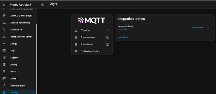

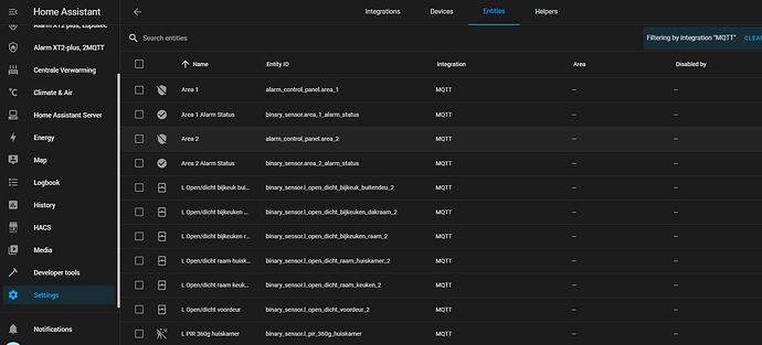

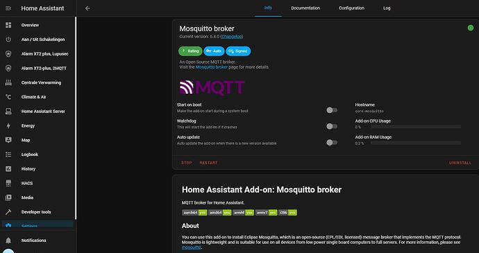

This is what I did:
  • Add lupusec2MQTT ADDON with the right configuration for MQTT and Lupusec Hub.
  • Add Mosquitto Broker MQTT ADDON (did not change config)
  • Add MQTT INTEGRATION under: “Setting” and “Devices & services”,
    it should automatic detect/connect-to Mosquitto and all entity become visable under
    the MQTT INTEGRATION. You can then setup your Dashboard.
See my screens:
Brilliant, that helps a lot and I found the issue. I put the wrong server IP into the lupusec mqtt addon. Now it works fine!
