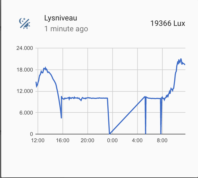

Here you can see a chart of light levels in my living room. I live quite a bit north so the sun sets at about 1600. After that, the lights come on. During the night, the level is zero. It peaks at about noon. Maybe that can help with the confusion
