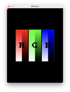

online_image does work on host, what doesn’t is the http_request it depends on, but you can use this PR for now.
