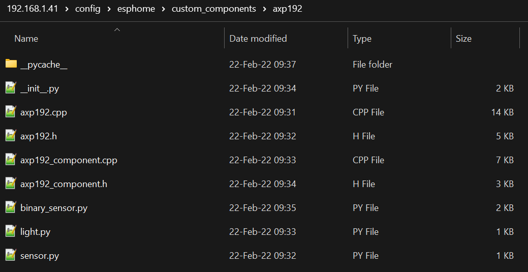

I got my M5Stick Cplus working too!
I am sharing my unfinished code as the screen is working and others can use it as an example on top of what you shared. The rest of the code is not fully functional yet (ideally it will control a fan in a network rack based on temperature, and Home Assistant will be able to override things such as disabling the fans so one can watch a movie without the noise - rack is in my media room).
The code below only works after placing the files from Ian Geiser in the components subfolder of the esphome folder.

Does anyone know whether the M5Stick Cplus can output a PWM at 25kHz? My code stops working if I use the frequency configuration to set it to 19kHz and my scope says the output stays at about 6%. If I comment out the line, the code works but there is an insane whine from the fans at about 1kHz. I can’t find anything that confirms whether the hardware, and specifically the GPIO26 output I used, is compatible with outputting a 19kHz PWM signal.
output:
  - platform: ledc
    pin: GPIO26
    #frequency: "19531Hz" #This breaks the PWM output
    inverted: false
Getting the following error…
I have to custom components loaded and also am referencing the git directly… thoughts?
ERROR Unable to load component axp192.sensor:
  File "/esphome/esphome/loader.py", line 162, in _lookup_module
    module = importlib.import_module(f"esphome.components.{domain}")
  File "/usr/lib/python3.9/importlib/__init__.py", line 127, in import_module
    return _bootstrap._gcd_import(name[level:], package, level)
  File "<frozen importlib._bootstrap>", line 1030, in _gcd_import
  File "<frozen importlib._bootstrap>", line 1007, in _find_and_load
  File "<frozen importlib._bootstrap>", line 986, in _find_and_load_unlocked
  File "<frozen importlib._bootstrap>", line 680, in _load_unlocked
  File "<frozen importlib._bootstrap_external>", line 790, in exec_module
  File "<frozen importlib._bootstrap>", line 228, in _call_with_frames_removed
  File "/config/esphome/.esphome/external_components/19e2b645/components/axp192/sensor.py", line 11, in <module>

Nevermind… its this … M5Stick - axp192 no longer working since upgrading to ESPHome 2022.3.0 - 16th March 2022 - #9 by nickrout
