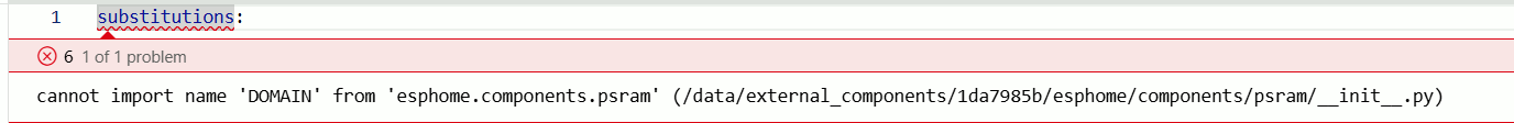

I have exactly he same compiling error with my m5stack Atom Echo and esphome 2025.8.0
After 3 more updates my M5Stack echoes still won’t update. There seems to be an error in the the ‘substitutions’ section as shown by the screen shot belo

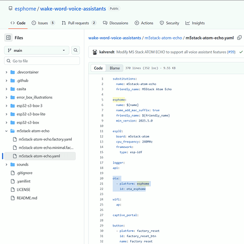

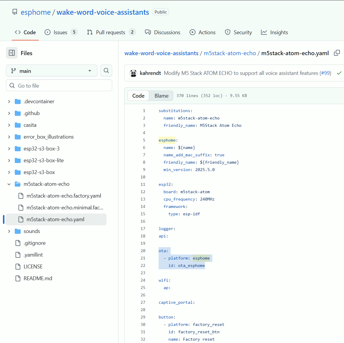

I sat and thought about it and decided to copy the code from Github into my yaml file, keeping the name substitutions, encryption key, ota password and wifi credentials. Validated the file and successfuly updated my M5Stack echos.
