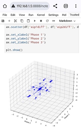

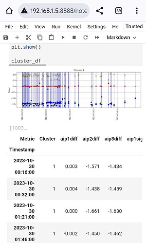

I did some experiments some time ago and was indeed able to pick up some patterns such as my boiler with different power settings.
It’s called NILM (Non-Intrusive Load Monitoring) and there are some papers out there on previous attempts. With data (down to second resolution if needed) I have both active and reactive load on three phases (and much more but i belive the delta from previous sample for those six measures is the interesting features.
Feature engineering probably includes time of day, month etc. With the data I used various clustering and dimentional reduction techniques.
I also did some FFT (Fast Fourier Transform) which revealed the cyclic patterns.
I did not complete the experiments due to lack of time but would happy to pick it up again.
Images from the experiment just for fun:
