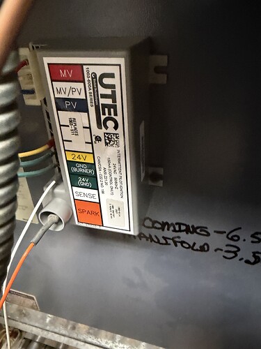

Okay, another call to the HVAC company. They come back out, check the natural gas pressure, and say it’s low at 3.8. It should be at least 5. So, I had to call our natural gas company, who sent a technician. Turns out, the pressure regulator and heater both need to be replaced. Now, we’re close to 7 pounds of pressure. I’ll monitor the heat for a couple more days after.

At this point, I started researching more on my own. From what I’m trying to understand, something with the pressure regulator or the controller could be the problem. I also spoke to a couple of engineers at work, and he offered to come over and check it. After about 10 minutes, he says he believes the electronic control needs replacing. We ordered a replacement one from supplyhouse.com, had it the next day, and installed it together. The boiler has been working great since.

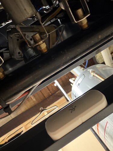

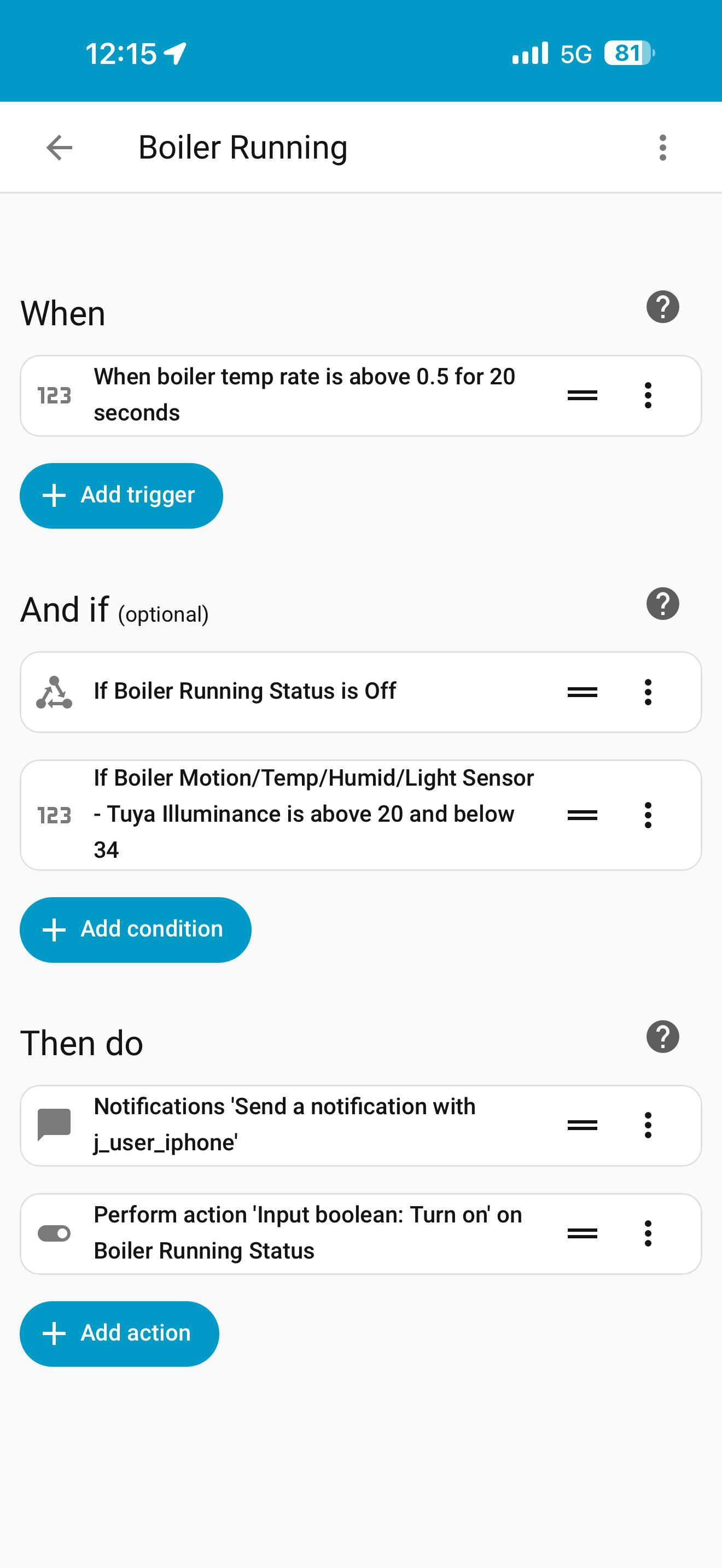

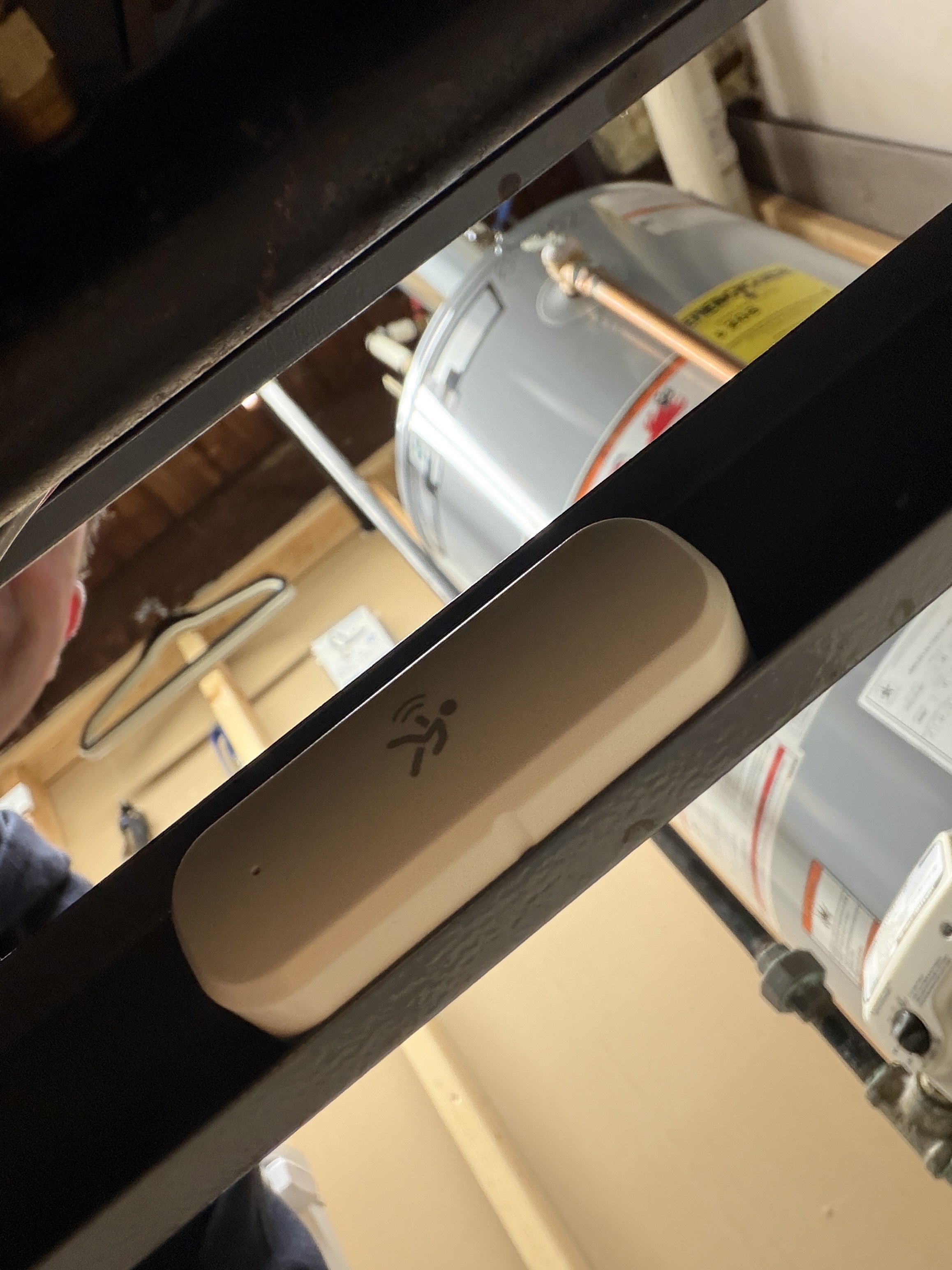

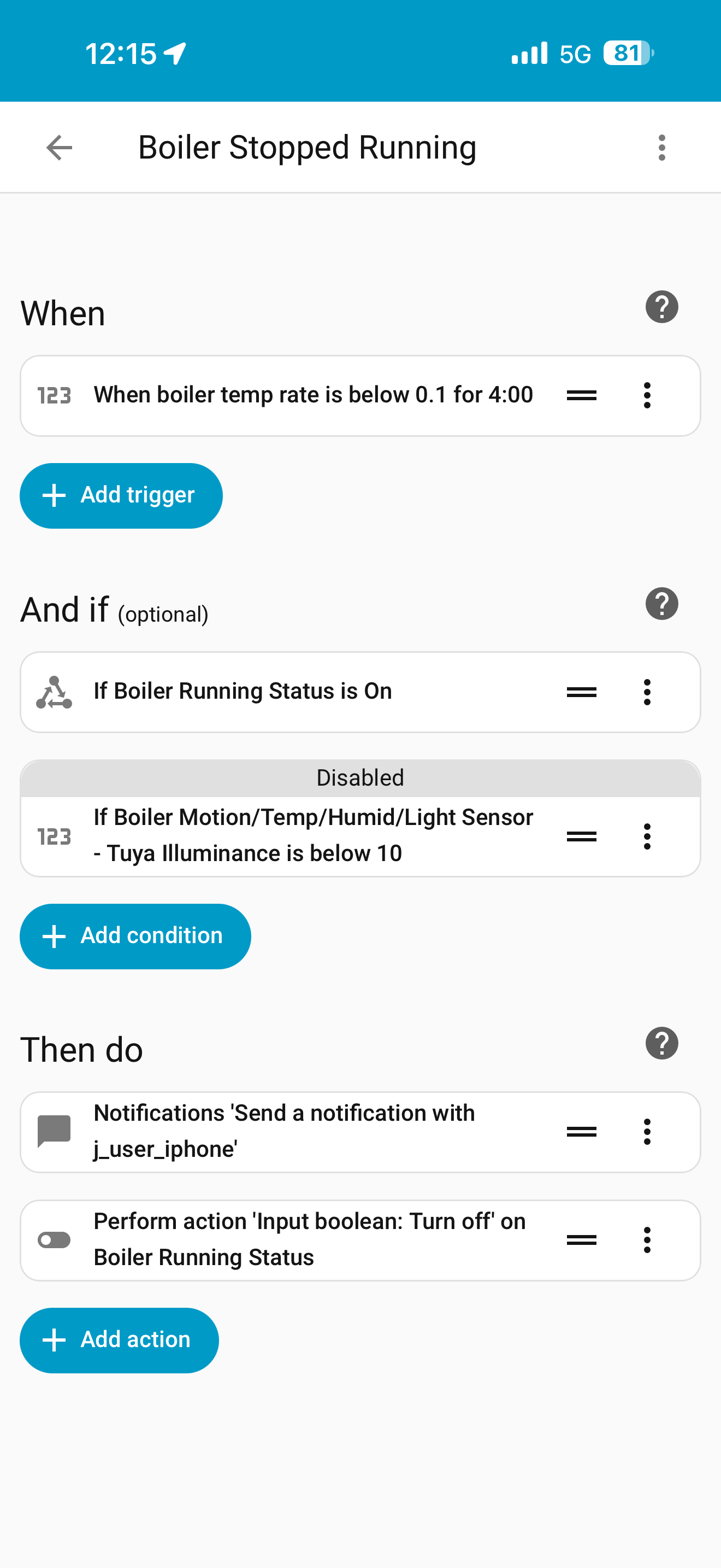

Here’s the main point of my post. I wanted a foolproof way to monitor the boiler to ensure it’s running and not stopping. I tried various sensors like vibration and light sensors, but none worked consistently. After days of brainstorming, I finally came up with the idea of using a Zigbee motion, lux, temperature, and humidity sensor. I mounted it under the boiler, close to the flame tubes, so my automations could detect the heat rising a certain amount of degrees over a short period. Additionally, I set a condition for the lux to be above 7 but below 20, as the below flames generate lux between 8 and 14 when the boiler is running.
The sensor would send a notification to my phone when the boiler started running. If the temperature dropped in a specific time frame, it would send a stop notification, including the time it ran.

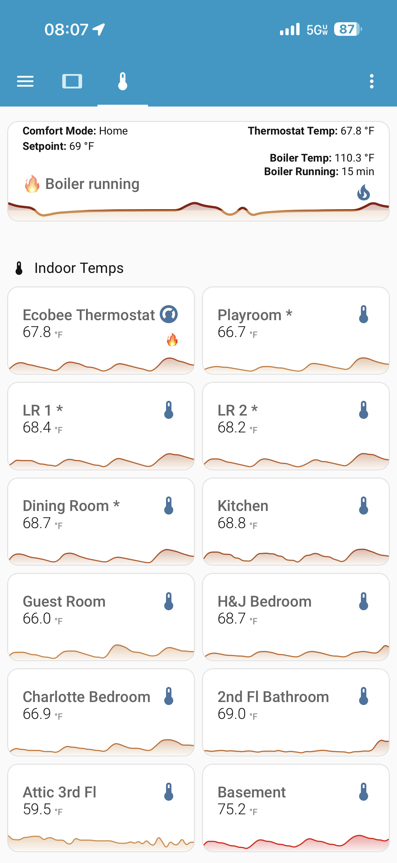

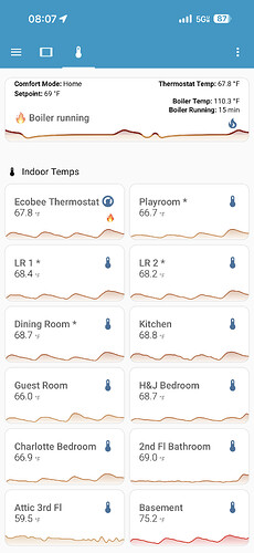

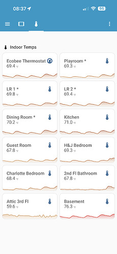

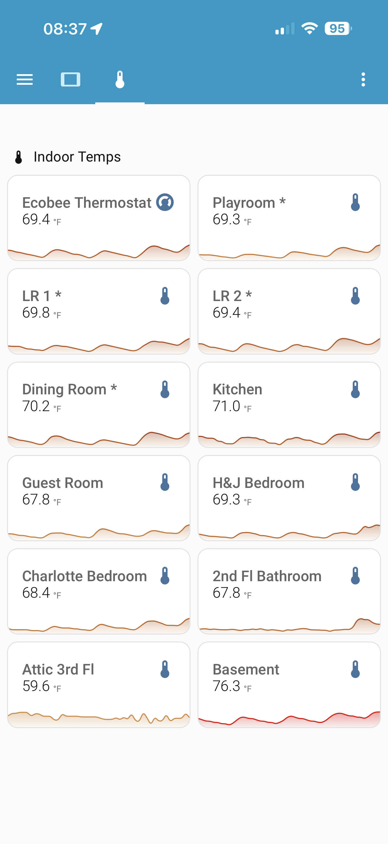

I also created a temperature vertical mini-graph dashboard card to monitor the heating of all rooms evenly. Only when the boiler is running will the boiler running card be visible. The graphs on the mini-graph cards use different shades of color to represent the warmth or coolness of each room. Another note is that I set the mobile notifications so that clicking on them opens directly to my indoor temperature card.
