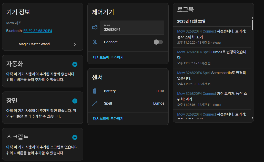

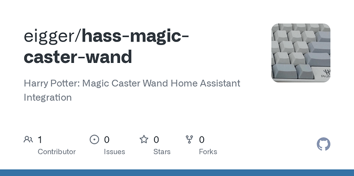

I received the wand I ordered today and did a quick integration test. Since I was only focused on testing the basic integration, I wasn’t able to implement sufficient exception handling yet. I plan to improve it gradually, so please treat this as a reference for now.

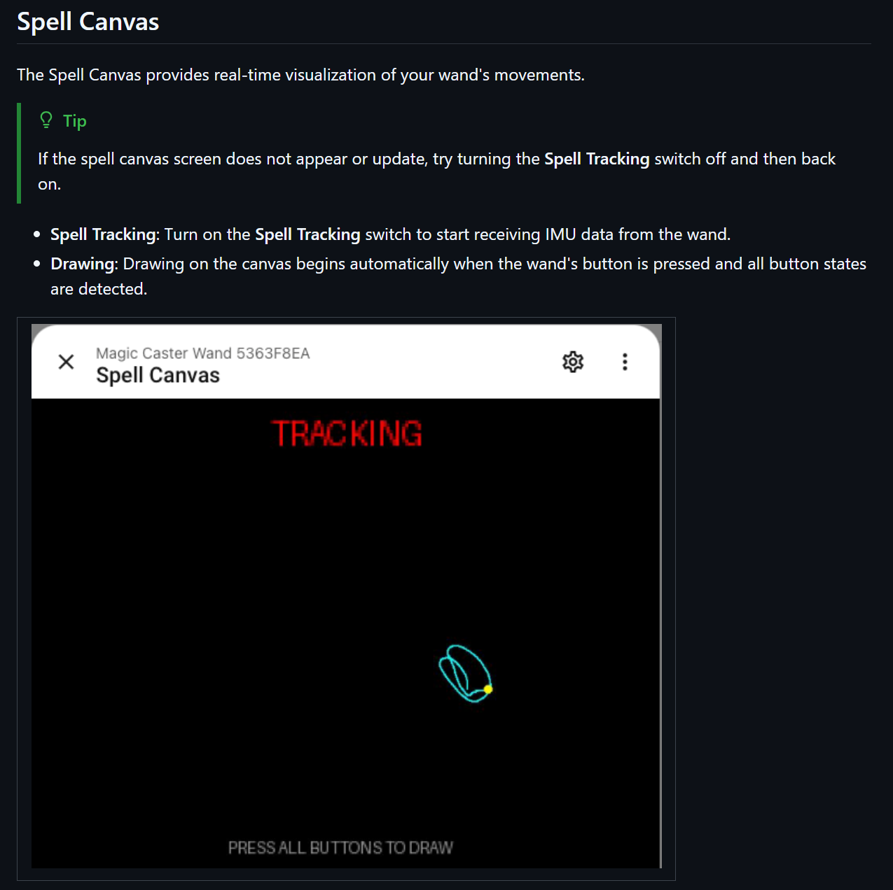

Got 2 from ebay and the 5 spells (Serpensortia, Protego, Lumos, Nox and Colovaria) work pretty well. To help my kids I am keen to get some feedback on the wands movement. Does anybody know how to run the Spell Canvas that is mentioned on github?
==> NEVER MIND, HAD NOT YET UPDATED TO THE LATEST VERSION

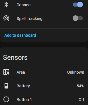

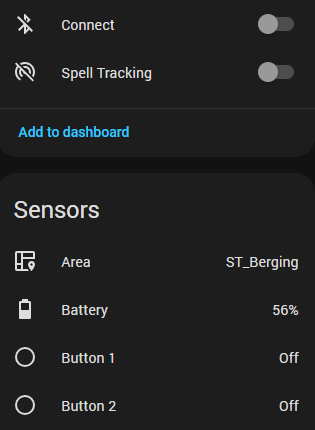

And I have the location of the wand (from the BLU proxy) but as soon as I connect the area becomes unknown. Anybody a good idea how to ensure I do know the location the wand is connected too?
------ Connected -----
------- Not connected -----
And if the wand is connected and a person moves through the house out of reach, would it need to be reconnect (i.e. using the connection switch in home assistant)?
I don’t think the integration does any area stuff… are you using Bermuda? I heard someone else mention the need to disconnect for that to work with the wands.
Yes, I am using Bermuda and indeed need to reconnnect to get the latest location. Bermuda is great and I am using the last seen sensor (so when it is connected I still have the latest location)
