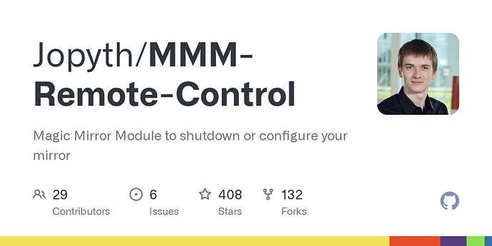

and the mirror MUST have This module in it

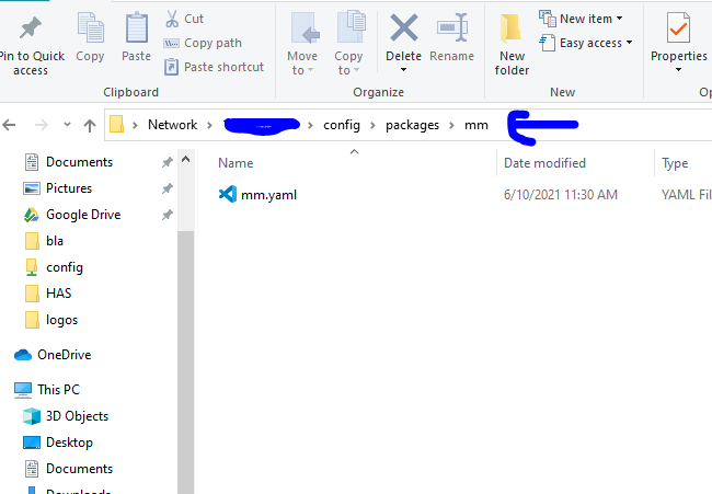

I see you have packages
then in the package folder
i have a folder mm
then In side that folder I have paskage data ( the config)
and the mm.yaml inside that
than that file has
