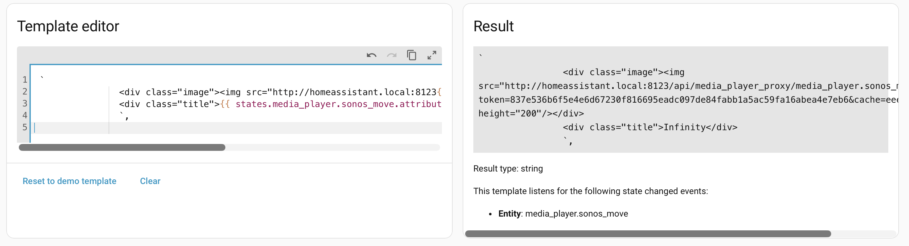

Hey wonderslug - first of all thanks for putting this together it was just what I was looking for. I am trying to set-up my first use of the model and copying the playing now and facing the same issue as kevmang. I did not see a resolution.
below is my module config. when i have the useModuleTrigger set to false all I see is “Now Playing”, when true I see nothing.
I can see in home assistant the media_play.sonos_move changing states and when i try the template debugger it shows what seems to be right - a URL for the image and song title.
Thoughts and/or suggestions on how I can debug further

Howdy
Looking at the config you have usetls set to true, but are referencing the image with http not https. That’s the first thing I would check.

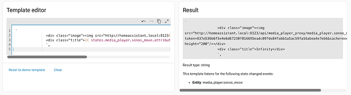

Thanks for looking. I tried both keeping usetls true and adding https:// and also usetls false with the original use http:// and still no luck :confused:
edit to add: below is what my template editor looks like. I see it provides the title of the song and link to a what i assume is the album art. I have not used templates before so not sure if the result is what is expected.
update: I did a sudo apt update on my raspberry pi that MM was running on along with the latest MM version update, rebooted, and now it is working as expected!
