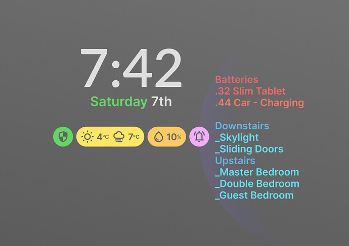

Examples of where it’s at:
Mockup of what I’d like to animation to feel like.
Mockup of what I’d like to achieve.

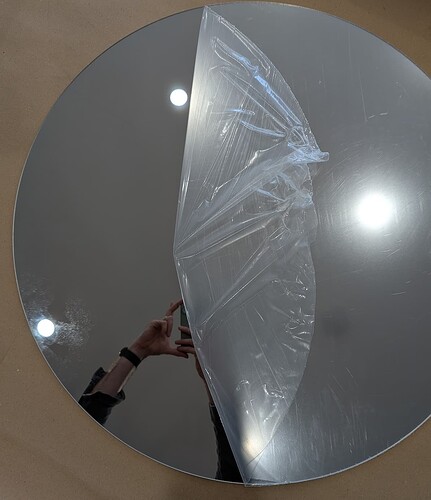

The mirror I will be adapting.
Test of info showing through actual acrylic (I’ll use black vinyl or something to stop the edge of the screen being visible.
Acrylic two way mirror, that will replace the current mirror in the earlier picture
So I’m trying to get the styling working for my list of items to show. I’m struggling with the CSS a bit. Despite not needing a button I’ve gone with the Custom Button Card as feel it offers a lot of flexibility, but am struggling to get things aligned as I’d like:
This is where I’d like to get to (visual mockup):
This is where I’m at (produced by below code):
I can’t seem to get the text to all push up to the left. I know this is basic CSS, but can’t seem to get my head around it.
The code is rather repetitive, but before I trying an improve that, just wanted to get something that was matching my design.
Any help very much appreciated.
