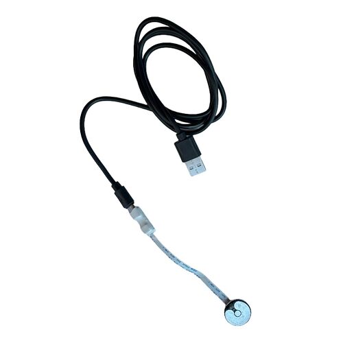

You could use something like this with a battery powered device though:
The important search terms are “<your sensor battery size> battery eliminator”.
