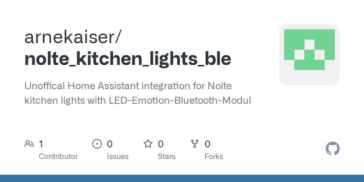

Hello! I had the same problem and wrote an integration for the bluetooth module and it works fine for me.
Feel free to test it:
