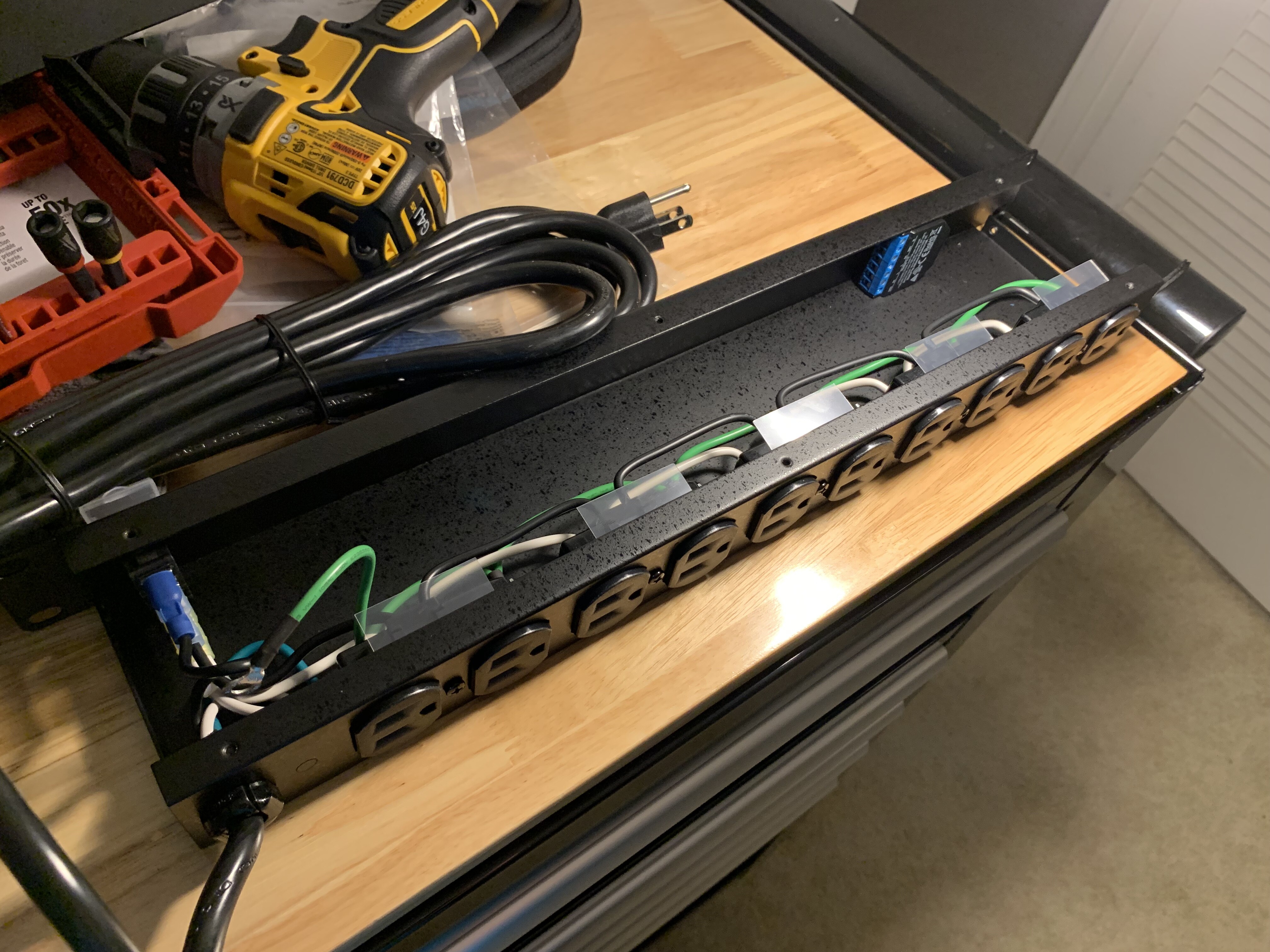

Guess I am going to try with a CyperPower basic model. There should be enough room inside, judging from the amazon pictures:
There is definitely enough room in this thing :slight_smile: The actual outlets are paired, so it’ll always switch two at a time, but I don’t mind that.
