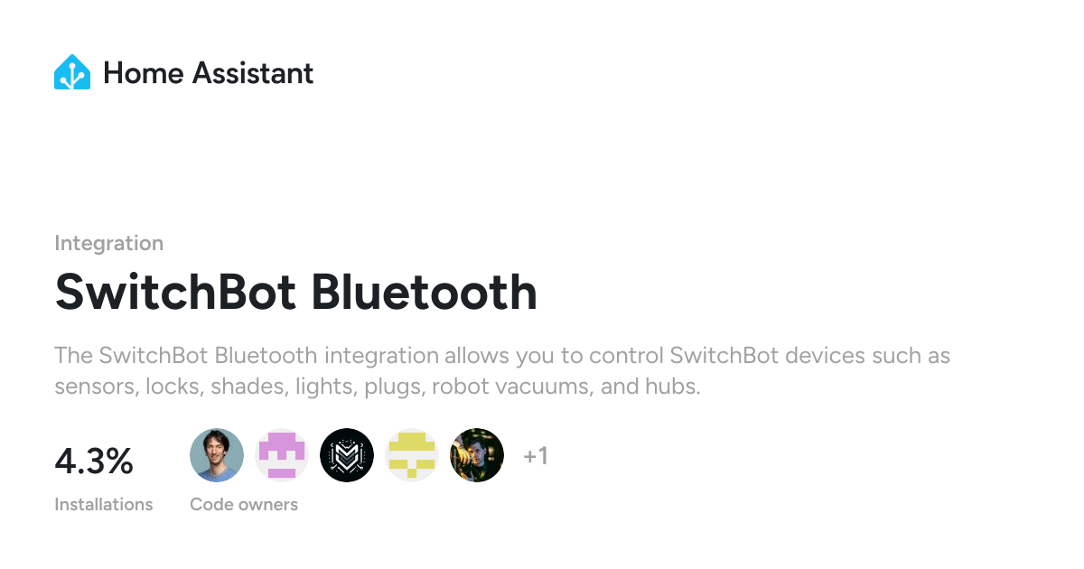

I have a bunch of switchbot blind controllers that use Bluetooth, and all I did was set them up in the Switchbot app and then go to Home Assistant and setup the Switchbot bluetooth integration. After that they were all sitting there waiting to be added. I’ve never had the minihub in the mix at all.
If these are bluetooth native devices, you should probably confirm they are supported by the Switchbot bluetooth integration.
After that, I’d suggest try removing them from the minihub (or reset them) and then set them up again in the Switchbot app.
