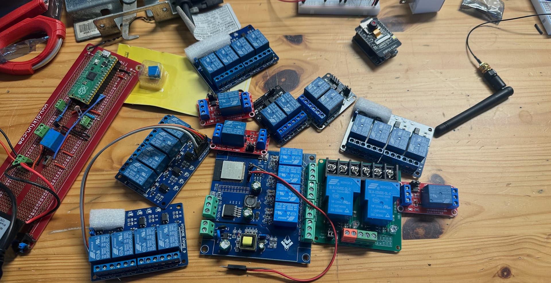

You asked for an image a few posts up, and I still have my version 1 controller using ESPHome and a gutted remote I bought on Amazon (like you showed) sometime back. (I don’t use this any more.)

You don’t need relay here. On 3V remote like image above you can connect it directly to Esp and drive it in open drain pin-mode.
For 12V remote use optocoupler.
Apparently everything needs relays… :wink:

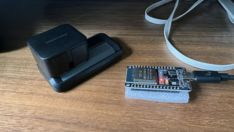

@Didgeridrew’s suggestion of using an ESP32 ended up being the right call. I had to download the appropriate driver but once I did setting it up via the browser was super easy.
The other thing I needed to do, and this is a heads up to anyone who tries to follow this… Go into Home Assistant, click on devices and configure the Switchbot Bot to not retry by setting it to 0. I don’t want it to retry. I just want it to fail. If I want it to try again I’ll push a button on my phone. I’m not certain this was a contributing factor in why sometimes the bot would trigger several minutes after receiving a command but I doubt it helped and, like I said, I’m OK with it just failing.
That being said, I basically have the ESP32 in a corner of my apartment directly over the garage door and the bot right next to it (within a foot) and it triggers basically instantly (1-2) seconds every time. I’ve tried triggering it several times in a row, each time succeeded. I’ve tried waiting long periods between triggers and each time it was instant and succeeded.

I’m currently in the “I’m building confidence that this will work and just randomly open my garage door” phase so it’s not finalized. The initial stuff I did had the button triggering at crazy intervals and zero predictability which nuked any confidence I had in use it. Unlike a lot of these little projects I’m doing I need to feel 100% confident in this before I deploy it. If this goes wrong my motorcycle could be stolen… Someone could take any of the stuff in the garage, etc.
Once I turned off the repeat stuff I think I’m probably fine to trust that if it doesn’t work right away it’s not gonna. So right now I have a button in HA that triggers a script and all that script does is tell the Switchbot Bot to push the garage door button. It’s not actually pushing the button right now. I have just triggered it a few times at random intervals to make sure the latency never changes and so far… It doesn’t.
As for parts:
  1. Switchbot Bot to do the pressing of buttons.
  2. ESP32 board to act as a Bluetooth Proxy.
  3. Garage door opener to be pushed.
Per some advice I read online I have the Bot right next to the ESP32. Right now the entire setup is in my apartment. However, if I need to I will move it into the garage somewhere since I have an AP down there for the washing machine.

I finally got around to wrapping this all up to a point where I could use it. I was out the other day and a delivery came early and had I had this up and running I could have gone, "Yeah, one sec," instead of "Just leave it there and I'll just have to hope it's still there when I get back." It was, but still.
So in the end this was all pretty simple to set up. For hardware:
  1. ESP32
  2. SwitchBot Bot
  3. USB power brick
  4. USB cable of your choice
  5. Spare garage door remote
I don't have a sexy case for my ESP32 so I just kept the foam on it so the pins remain safe. It sits in a cupboard that no one goes into so I imagine it'll be safe until I finally break down and buy a 3D printer (that day is coming). As for the remote, I just stuck the Bot onto it so the sticky bit contacts as much of the surface as possible while still allowing full actuation of the button (see below).
