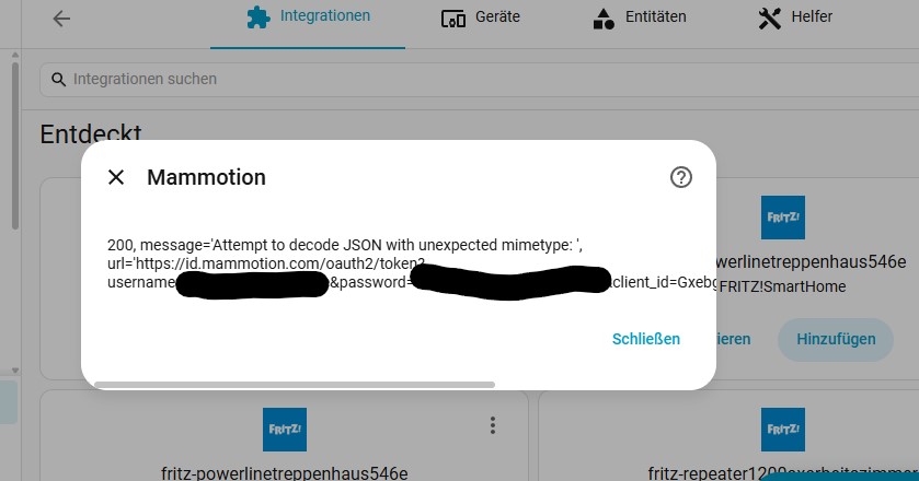

Need Help, Have a Luba 2 mini 1000 can´t integrate hav second account on mammotion but i get allways the same error

The integration needs a patch. Looks like the last update accidentally caused a breakdown of the Mammotion cloud because the server got spammed with requests.
That’s what people wrote in the Facebook support group

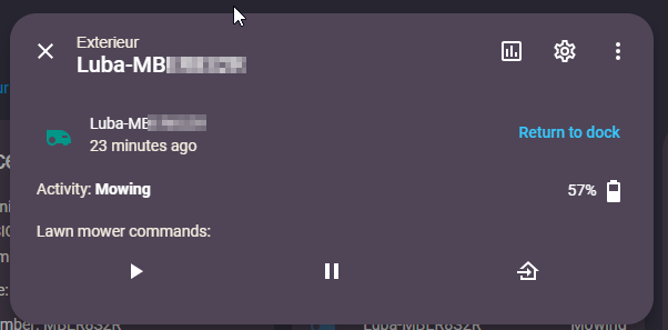

Just got my Luba Mini 2 AWD 1000 today, and already integrated with my HA (via WiFi, and secondary account via gmail alias [email protected] ) and there seems to be a “return to dock” action
