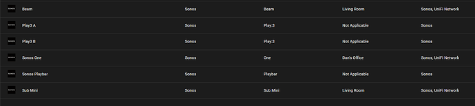

In the below attached in the integration column for the specific device, today the sonos integration is taking precedence, but there are other times (with nothing else changing in the network) the icon is unifi, and unifi is listed 1st in the integration column (therefore changing the associated device Icon to be the “U” from unifi integration.
While the Unifi integration is trackers for my network devices, Home Assistant seems to associate that device to Unifi prior to Sonos on occasion.
I am not sure if this is even getting to the media player entity level, but I am novice at best, so just speaking from what I have observed thus-far.
Type beam in the search field at the top of the devices list. What does it show?

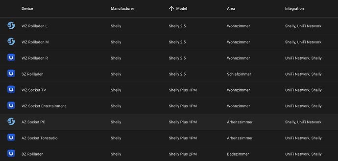

Most of my devices now show the unifi icon instead of the icon of their primary integration. The screenshot above shows only Shelly devices.

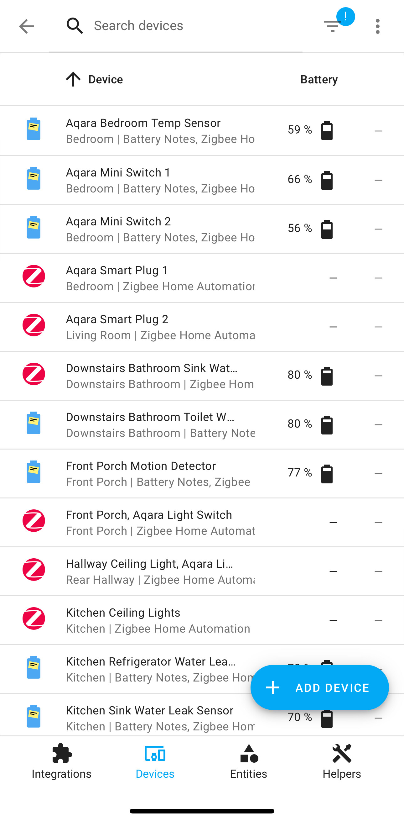

Same exact thing is occurring with me, specifically the Battery Notes integration icon randomly replacing my zigbee device icons. I noticed it usually changed around during HA restarts. I’m surprised this was the only thread/post I could find for this issue.

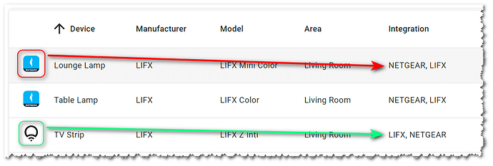

+1 would like the primary to be LIFX and the supplementary to be NETGEAR in my example

As you can see only shelly devices, but most of them are unifi.
Other Integrations show similar behaviour.
The media player entity mentioned before of course is not from unifi, but we are more precisely speaking of DEVICES not ENTITIES.
DEVICES shouldn’t be using any DEVICE TRACKER Integrations for primary Integrations, those type of Integrations should always be supplementary, OR it should be a fixed manual setting per device.

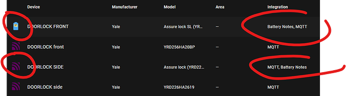

Same issue with Battery Notes, random integrations order/icons;
