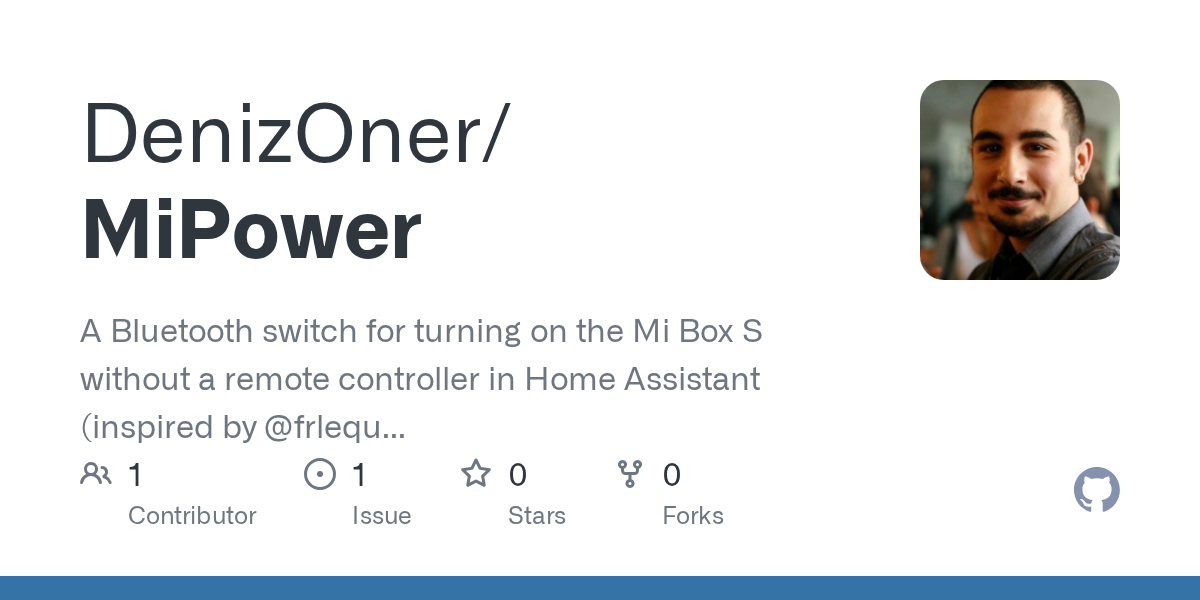

I solved the problem.
You should check out this repo:
