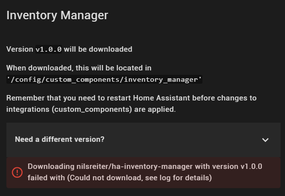

hi, thanks, this looks like it can save me a lot of manual helpers and automations, so I want to give it a try.
But it does not want to install.
I also tried with the beta version.
Download failed - Got status code 404 when trying to download https://github.com/nilsreiter/ha-inventory-manager/releases/download/v1.0.0/inventory_manager.zip
Download failed - Got status code 404 when trying to download https://github.com/nilsreiter/ha-inventory-manager/releases/download/v1.1.0-beta2/inventory_manager.zip
  File "/config/custom_components/hacs/base.py", line 709, in async_download_file
    raise HacsException(
    ...<2 lines>...
custom_components.hacs.exceptions.HacsException: Got status code 404 when trying to download https://github.com/nilsreiter/ha-inventory-manager/releases/download/v1.0.0/inventory_manager.zip
Please try again with v1.0.1, I changed something in the metadata scheme (and I can now reinstall it).

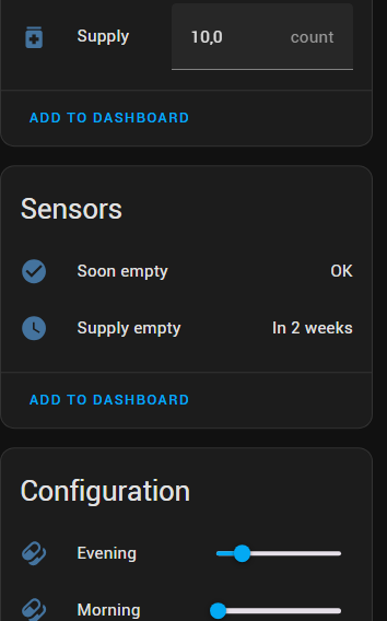

last question (hopefully :wink: ), just to confirm:
Should I create own automation to subtract the configured evening usage? Or should the integration decrease the Supply automatically (which did not happen last night, so I assume own automation)?
Yes, you should create your own automation.
