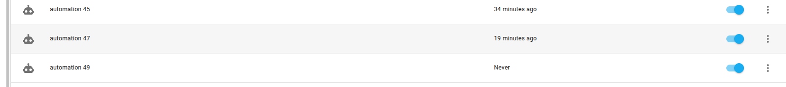

Manual automations all show up in the front end as Automation xx
I have the following set up for automations in configuration.yaml

The automations work correctly. However in the front end Settings/Automations & Scenes/Automations, It shows up as:
Where it says the automation is unavailable. But then I have a lot of these automations:
Which seem to be the actual functioning automations, but with only a cryptic Automation xx (and it can’t be edited since it isn’t in automation.yaml)
What gives?

Each hyphen starts a new list item, so the screenshot shown above represents 3 automations, with the first 2 being invalid due to missing required keys.
