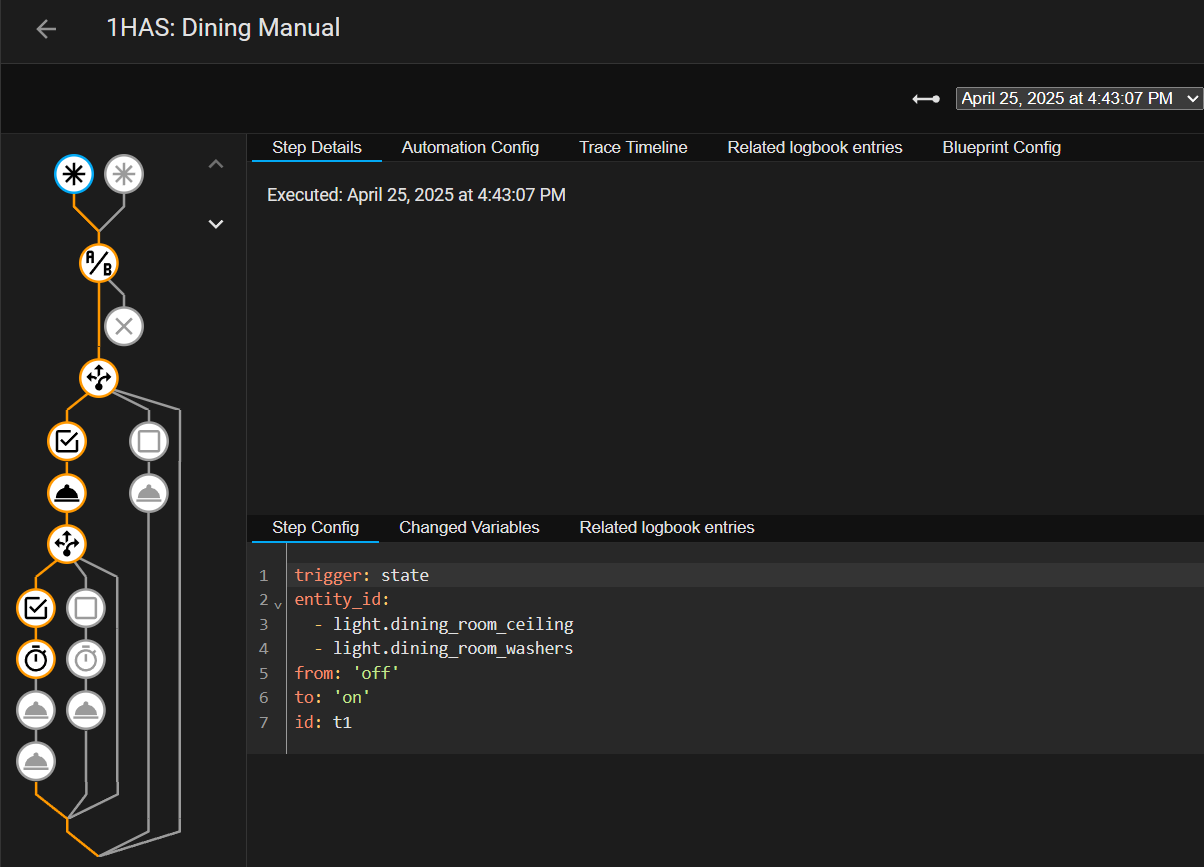

I have an odd situation where it seems that an automation turning on one of the tracked entities is causing the Manual Control Status Tracker to trigger and turn the Toggle Helper ON.
See this trace for the Tracker automation at 4:43:07:

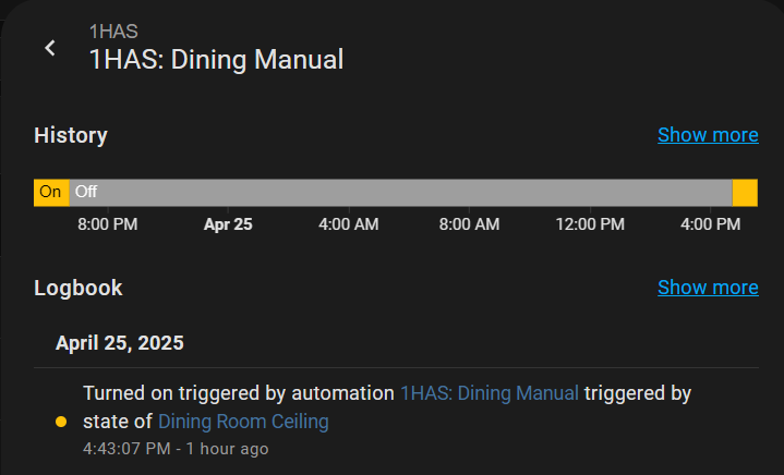

And this is the logbook entry for the Toggle Helper at 4:43:07:

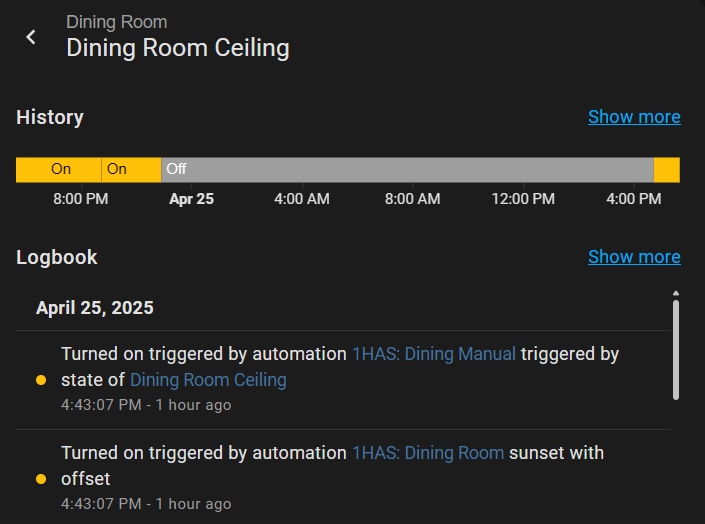

This is the logbook for the Dining Room Ceiling, showing that the automation turned it on at 4:43:07:

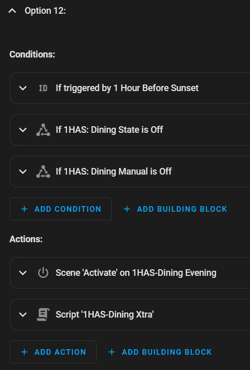

This is the Action in the 1HAS: Dining Room automation:
It runs this the Evening scene that turns the dining room Ceiling and Washers entities on at set brightness settings. The ‘Dining Xtra’ script controls a different light.

I see… The light is being turned ON by a scene.
I never tested this.
So what is happening is the automation turn the scene ON but the scene turns the light ON. The logic is only if an automation turns ON an entity not a scene to turn ON an entity.
This is why when the automation turns ON by the sun it also runs the manual tracker.
I not sure how your scene are set in the automation and whether you can just use entities and set the light/s up like that.
I will put this on my list to look at. Thanks for pointing that out.
