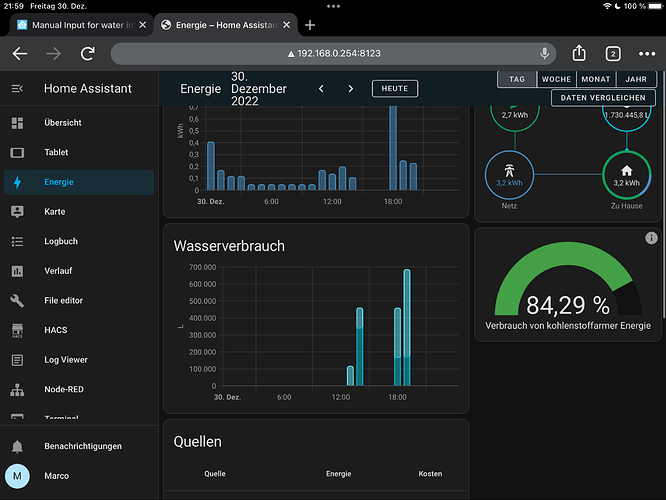

the value in the input sensor are added together in the energy area
Is there a solution for this?
The purpose of water in the energy dashboard seems to be to track the source utility-meters, not individual devices. For this usecase summing the sensors is the way to track your consumption.
There is no extra tracking individual devices like for electrical power.
okay, i already thought so and removed it from energie, what does your solution look like?
do you use it as a history card?
like this:
Actually, I only have two source- meters so that’s no worry for me.
If I had, I’d probably use the apex-chart card from hacs. (Provided, that it can access the long term stats, didn’t check)

I’d first like to say big thanks to @elfrinjo for sharing this! This is exactly what I was looking for.
To @ehorsting1982 what if you change meter_wasser_erlenbach: to name: "meter_wasser_erlenbach"?
I got it right this time. Not yet seeing anything on the energy dashboard, but I will give it some time.
