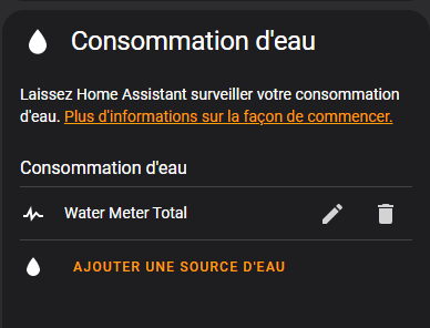

In parameter - dashboard - energy
Do you added the value like mentionned or you don’t see the value appearing when click on add button ?
Add source:
example:

If i understand correctly, what i have is :
    1. One input_number i can increment to correspond to my real counter
    1. One “template” sensor in my configuration file that is incremented by the input_number
    1. One energy sensor, created in the entity page of HA based on the previous sensor
For electricity, i can add the sensor (3) to the energy dashboard and it’s wokring. The sensor (2) is available too. Everything ok here.
For water, only the sensor (2) is available, but not the sensor (3).
The only thing i would like is to be able to manually set how much electricity or water i’ve consummed each month or week, to keep track on it.
Maybe i’m doing it wrong, or there is a better way ?
Hey @vingerha, it’s working with only sensor 1 and 3 of my previous answer. Thanks a lot :wink:
