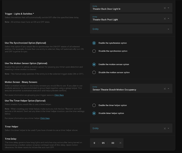

Curious how this handles when a light is being set by an automation?
I have a few automations that control these same lights I do in the BP screenshot below. Thus, when the automations set the light (2 dimmers controlling the same) I dont want the 5 minute timer to turn off the dimmers/light.
Would this conflict with my other automations? Does Manual Light need a Bypass option to make it not conflict?

This blueprint is designed for manually turning a light ON and having it automatically turn OFF after a preset time. It’s ideal for spaces like a garbage room or areas where you frequently enter and exit within a set time frame but don’t have a motion sensor. Simply turn the light ON, and it will turn OFF automatically.
Additionally, this blueprint offers an option to use a motion sensor to keep the light ON if it was manually turned ON… perfect for scenarios like a reading lamp where you want the light to stay on while motion is detected or if you’d like to manually turn it ON and have it remain ON as long as motion is present.
If you manually turn ON a light and don’t want the timer to turn it OFF, simply don’t use this blueprint… just turn the light ON as usual.
I designed this because when using the Sensor Light Blueprint, I wanted the option to manually turn ON some lights occasionally and have a motion sensor turn them all OFF together. These lights are not linked to any automation, allowing for more flexible manual control.
Edit: You can toggle the automation (Enable / Disable). There is no need for extra bypass control as the trigger is manual.
Blacky :smiley:
