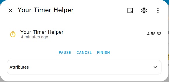

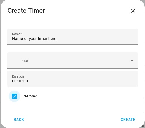

FAQ - How do I create a time helper?
  1. Go to Settings / Devices & Services / click on the ā€œHelpersā€ tab / click ā€œ+ CREATE HELPERā€ and select ā€œTimerā€.
  2. Enter in the name you would like to call your time helper. Select an icon if you like. Leave the duration set on 00:00:00 as the automation will apply your setting to this. Click ā€œrestore?ā€, this will restore / keep the time helper going if you restart Home Assistant.
    2
  3. Your done. Now just add the time helper into your automation.
TIP: If you add your time helper into a dashboard and you click on it you will be able to pause, cancel or finish it.
3
