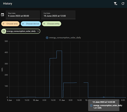

I had very strange behavior from the utility_meter sensor, for two days I had 100x values. Then everything worked as before.
How do I delete or reset the two days?
I tried with .reset and since I have no tariff it does not work.
service: utility_meter.reset
  entity_id: sensor.energy_consumption_solar_daily
With .calibrate I can only for the current day new value set also zero.

“sensor.energy_consumption_solar_monthly” deleted, HA restarted and the same sensor created again. The old values were saved anyway.

I’ve been having the same problem with the utility meter for a few days now, it’s showing values like 1000x bigger than it should.
All sensors were created using helper.
Anyone has a solution for this?
Same problem here.
If i manually change values using developer tools then it jumps up again later…
Sorted out…
With calibrate service it fixes the problem…
