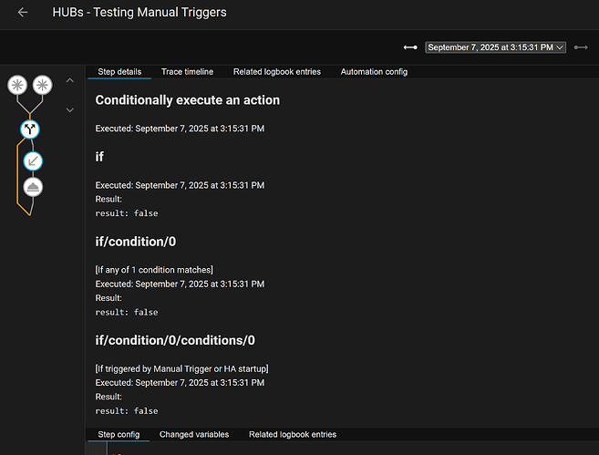

Why does this fail to execute on a manual Run Actions ? It shows in the traces that it executed but somehow the manual trigger fails to pass the conditions. If I remove the condition it executes correctly.

Because the Trigger Condition has nothing to check.
Your automation’s two triggers have id variables but they’re defined only when the automation is triggered by one of its two triggers.
When you execute the automation via Run Actions, only the actions are executed, not the triggers. So there are no id variables defined and the Trigger Condition can’t check them (so the if statement evaluates to false and the dash_cast.load_url action is not executed).
tl;dr
You cannot test an automation’s actions using Run Actions if they refer to a trigger’s id.

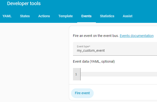

Please note that an event_type is required for you to actually fire that trigger from the Events tool, so your original trigger with an empty string as the value for event_type will not work.

If you intend to use an Event Trigger for the purpose of testing your automation, you can set event_type to a string of your choosing (as per Didgeridrew’s explanation). Then use Developer Tools → Events to fire your custom event.
