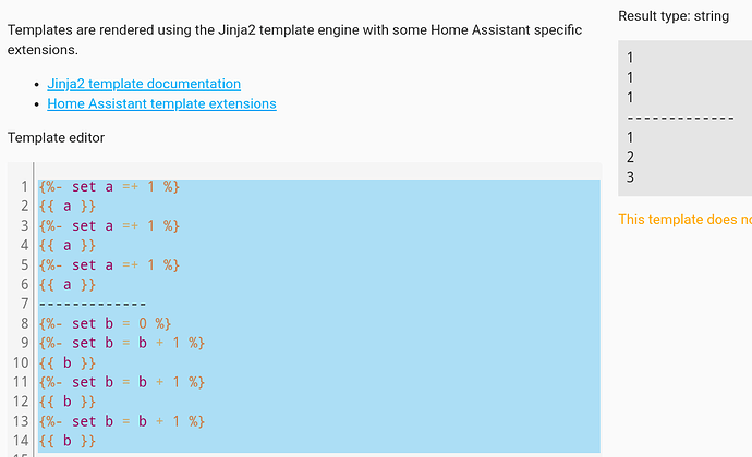

The reason it behaves the way it does is due to the use of the += operator. The variable always gets reset.
Compare the results of using += and + in the Template Editor:
It’s the loop scope on variables inside automations. Which have similiar limitations to jinja. They aren’t the same as you can get around it in jinja with namespace. In automations, you can get around it with a counter entity.
EDIT: Just to clarify further here. The real limitation is that you cannot alter an existing variable in the current namespace of an automation.
What are you trying to do? I’ve yet to come across a need to store the current index in a variable. I believe what you’re doing can be simplified or altered. Can you explain that instead of this question? Why do you need to count the cycle? Are you aware that repeat.index is a variable that exists during looping that contains the index?
FWIW, I wasn’t even aware that the Jinja2 interpreter supported the += operator (the sandboxed python_script integration doesn’t) so I tested it and discovered that it doesn’t quite behave as one would expect; it simply re-initialized the variable each time, even if the variable already exists and contains a value. In contrast, the + operator dutifully incremented the variable.

The error in the script is that the operator you want is += not =+.
set a =+ 1 is the same as set a = +1 is the same as set a = 1, so a will always be 1.
set a += 1 is the same as set a = a + 1.
