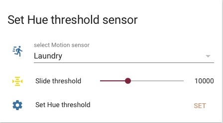

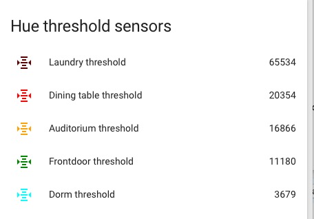

UPDATE
with Tiles, mimicking the Hue App:
