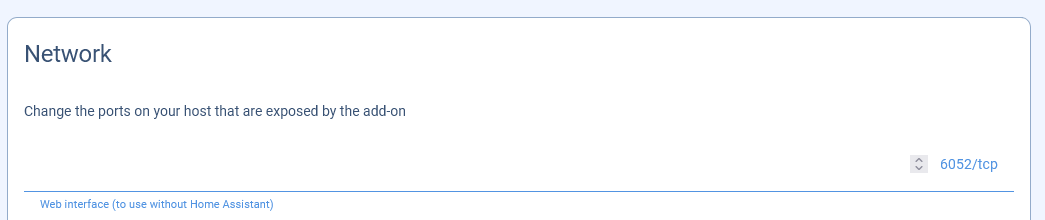

No. Add-ons always have the same IP address as Home Assistant. The only way to differentiate them is via ports. I don’t know anything about the Bifrost add-on but most add-ons allow you to specify the port they use at the bottom of the add-on configuration page:
