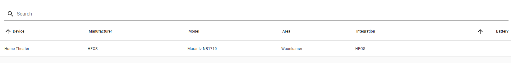

I’m quite new to HA and can see my Marantz NR1710 in HA by adding the HEOS intergration.
The problem is that not all functions are working. for example the ON/OFF is not working.

Have you checked other mediaplayer entities? For my marantz I have two media player entities: 1 is called: media_player.marantz_sr7011 which seems to be generated by heos integration. In that entity I cannot turn off the player. The other entity is called: media_player.sr7011 and with that entity I can turn off the amplifier.
Hi tom,
no the heos integration only gives me 1 entity. (called: ā€œmedia_player.home_theaterā€ by default)
If i go to Configuration -> integrations -> Heos:Controller than i see it has discoverd the correct device info like model. if i click this line i even see the firmware number.
strange…
But did you also include the denonavr in your configuration.yaml? I have this
